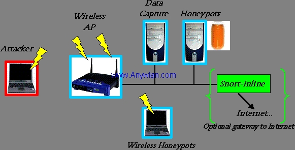

4.2 Wireless architecturesYou will first need at least one device that offers wireless access. If you choose to use a real Access Point, then you can safely plug it on a wired network (with at least one computer) with visible resources playing the role of targets on this fake network, and invisible resources to record data and detect intrusions (data capture). To monitor wireless-specific layer 2 attacks, one can use data capture on a wireless invisible client in mode Monitor, using software such as Kismet. An example architecture is shown below in Figure 1:
Figure 1: sample WiFI honeypot architecture
If you want to offer Internet access on the honeypot network, to improve the realism and interaction of your network, you should be careful and filter the outgoing network traffic to forbid attacks using a kind of Intrusion Prevention System, like snort-inline from the Honeynet Project. Most of the time, people don't want to make an Internet connection available to a wireless honeypot because of the related risks. Notice however that doing so can be used to understand blackhat activities: where do they want to go on the Internet? How do they try do go on the Internet?

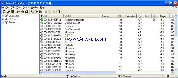

5.2 FakeAPIf you remember the movie called War Games, the young adolescent was using a modem on the phone line to scan remote phone numbers and find open lines like BBSes. This activity was called wardialing, and by transposition in the wireless world, people talking about wireless scanners or wireless listeners as wardriving, or even warwalking. Wardrivers try to find open networks. A good first idea to delude those potential intruders would be to simulate as many fake networks as possible for them to lose time and patience. Targeting one network is an easy task, whereas dealing with a cloud of targets could be more difficult.
This proof of concept was done with a tool called FakeAP [ref 5], free software distributed under GPL by the guys from Black Alchemy during the Defcon X. This tool can send specific wireless network traffic to fool basic attackers. As a wardriving countermeasure, it generates 802.11b beacon frames as fast as possible, by playing with fields like BSSID (MAC), ESSID, channel assignments, and so on. This trick is easily created by playing with the tools used to manage a wireless card (under Linux, that's like manually playing with: iwconfig eth1 ESSID RandomSSID channel N...). A remote, passive listener should then see thousands of fake access points! To quote the web site of the authors: "If one access point is good, 53,000 must be better." The idea behind this simple tool was quite good when it was first released, and you could even detect NetStumbler users by looking at 802.11b probe requests/responses. Whereas now, most updated tools can advise the attacker that the detected access points are unusually strange, such as these cases where no traffic is generated on the found networks. Figure 4, below, indicates a NetStumbler scan on one of these honeypots:
Figure 4: NetStumbler scan on a FakeAP honeypot
